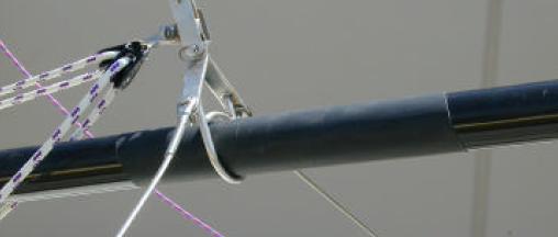

Run the pole through a stainless ring below the bridle instead of drilling holes in the middle of the pole for rivets. Similar to what is attached.
My I-17R used a ring that had three eyelets welded on at 12, 4, and 8 o'clock for the guy wires. It also had heat shrunk rubber on the pole in the area where the ring made contact.
