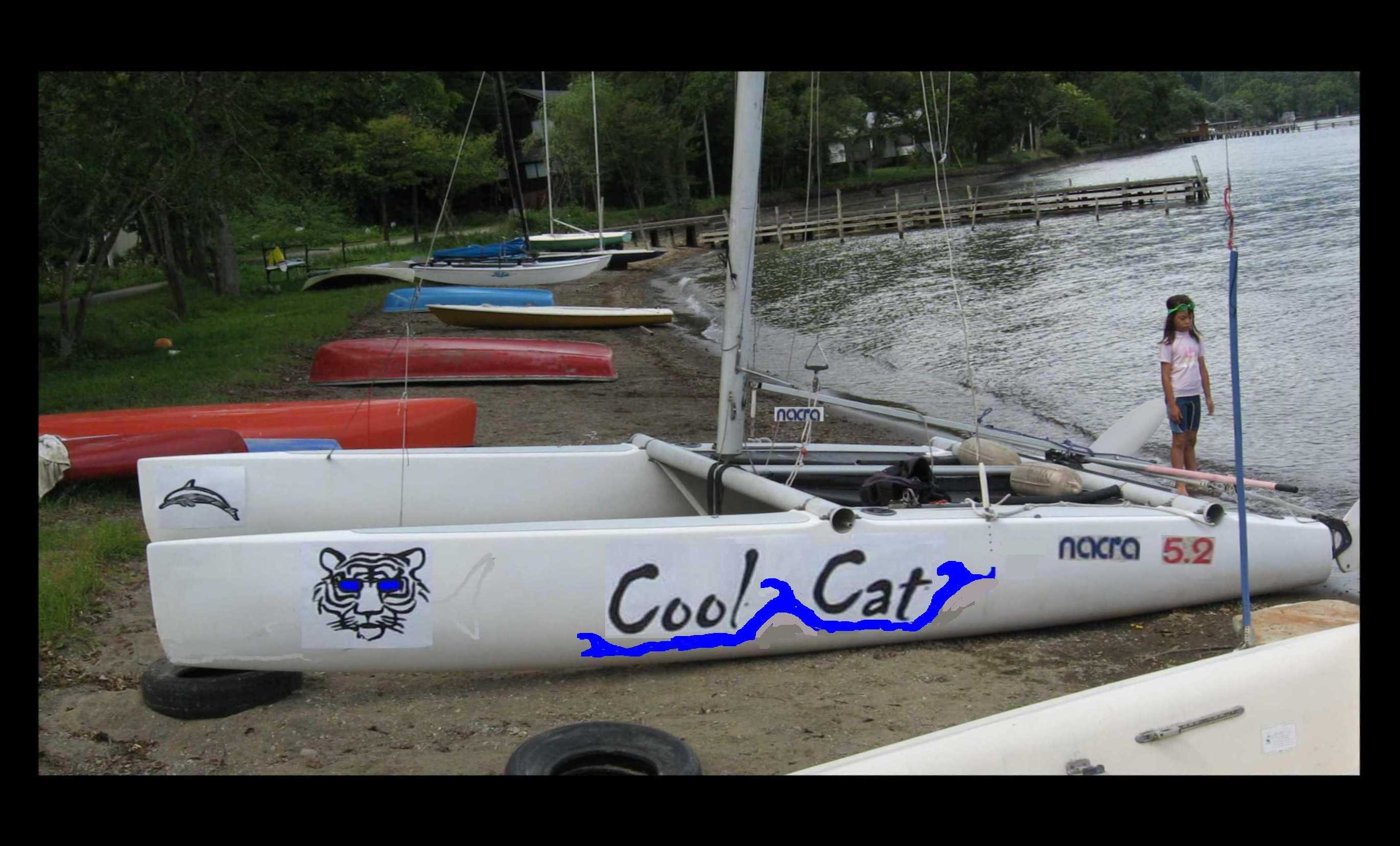

well someone's not getting it
have dug through my pics and this seems to be the best shot i have of the join that seem to be giving you the problems
eric e
1982 nacra 5.2 - 2158
2009 weta tri - 294

Eric, I have been drinking so I might be seeing things but looking at that it shouldnt turn....does the bar rotate upright? In that picture the "hinge" is 90 degrees off where it needs to be.

OH, and clean that boat up!!! I can see myself in the side on my 5.2, and it is older than yours. That boat is due a good cleaning and buffing with teflon wax.

that pic is from when i first got and assembled the boat
like azcat my rudders sometimes bind and as per my original post to this thread i tracked it to those "universals", as i called them, rotating into a binding position
when i feel them bind my solution has just been to twist the rudder extension which moves the joints out of the bound position and allows the rudders to turn
Rhino pointed out that murrays sold an updated part where the joints were fixed at a certain angle, presumably because many early nacras suffered this problem
my 5.2 is now in parts out at the lake but next spring when i put it back together i will be experimenting with ways to fix those joints at the correct angle to stop the rotation and binding
OK, now about my scruffy hulls, attached is what they looked like when the boat was first offered to me!. the rudder shot is after basic scrub down. since then i've spent a few hours sanding and using compound to get the hulls looking like gelcoat again. now the boats in bits for winter i can proceed with a bottom job and then start on my planned graphics job

Eric, I think to redeem yourself you will have to show us a picture of the boat once she is cleaned up.
