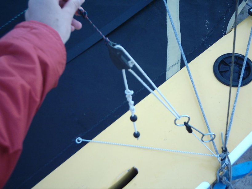

Robi, here a pic of my skipper trap setup #49811
05/23/05 11:25 AM
05/23/05 11:25 AM
Wouter Offline OP
Wouter  Offline OP
It is in its "light weather storage" position = away from the trampoline and far forward. In strong winds I don't run it through teh ring near the sidestays but fix the hook to the dogbone right away it comes up through the trampoline. I'm using the same 3 mm dyneema line for my trap lines as I do in my mainsheet system. I actually swear by this line. It takes 500 kg before breaking and it weights less than water so it floats. Steel wires weight 7 times the weight of water per given volume. I also use this line as spi pole support lines. It is too thin to use as trim line, but its is again in the second and third stage of my cascaded downhaul system. It is rather flexible you see and this improved the eefficiency of these systems alot !
If there is any problem with this setup it is that it may sometimes be difficult to unhook. At least with the trapeze harness I use. You don't have the flexing of the bungee to give you some extra slack to flick it out of the harness hook. I know what alot of others are saying about this setup but they really don't know what they are talking about. I have it on my boat, I tried it and I raced with it. With expensive blocks it may be better but I consider everything from a cost to performance perspective and this setup scores high. And there are also less components that can break or foil up. Found that reducing the number of components used with both make the boat clean and easy to sail and make it more dependable. If not more inexpensive.
The trapeze for the crew doesn't have the jam cleat adjusted and is setup more along the lines of the conventional system. A small block is at the end to the trap line and a line with jammer and bungee on one end and a dogbone on the other.
I can really recomment the plastic hooks at the end of the bungee cord as soon in the picture. They give excellent functionality, better then sisterclips and alot cheaper as well. Also going form "light weather storage" position to heavy weather position is really simple. Unhook and let the hook slip from your hand. The hook is too big to go through the eye in the trampoline. Than you grap it again and hook it onto the dogbone again. Finito ! It is also great when putting the boat on or off the trailer.

Re: Robi, here a pic of my skipper trap setup [Re: Wouter] #49812
05/23/05 11:36 AM
05/23/05 11:36 AM
Posts: 202
pkilkenny Offline
pkilkenny  Offline
Posts: 202
Do you know - will 1/8" Yale Pulse line (Spectra core; 800lb. tensile) suffice for trap lines (i'm about 150lbs.) ?
Re: Robi, here a pic of my skipper trap setup [Re: pkilkenny] #49813
05/23/05 12:20 PM
05/23/05 12:20 PM
Wouter Offline OP
Wouter  Offline OP
I personally distrust spectra. Everybody tells me Dyneema and spectra are the same fibre, but I don't believe that. All who have used spectra as trap line seem to have snapped it. Also I ONLY use 500 kg line. I can get 300 kg line that is supposed to be 3 mm thick but is actually 2.5 mm thick and that one has snapped on me in varying uses as well. So be careful with cheap imitations. Get the ral thing ! It works. As far as I can tell I only use Marlow 3 mm 500 kg line.
800 lbs = 363 kg and is probably to little. Remember that the knots and such do degrade a line to about 50%-60 % of its nominal strength. And you also want about a factor of 2 as safety margin to withstand G-forces and shock loads.
If you really want Paul I can buy and send you the stuff. You'll need to transfer the money to me up front though.
What I did with my own line is buy plastic swages and stitch the line around it. Than I slide a handle on the line and use a figure 8 knot to position is. A loop on the bottom end with a fishers hitch is used to attach the adjusting jam cleat or a small block. This hitch is easy to undo and you can replace the block at any time without using any tools and it can never get undo due to vibrations. Added benefit ? You can cut the line with your sailing knife = added safety !
Ohh and another advantage is the fact that because it is so light you only need very mild tension on the bungees to keep it straight and it won't bang and rube again you mainsail.
I've been using these dyneema traplines for years and so too several befriended crews. We all swear by it. However I must say that both Phill and Kirt used some line they could get locally (spectra) and these both failed. So I think you must look for the right line. And I think the 500 kg is the one

Re: Robi, here a pic of my skipper trap setup [Re: Wouter] #49815
05/23/05 12:38 PM
05/23/05 12:38 PM
Posts: 202
pkilkenny Offline
pkilkenny  Offline
Posts: 202
Thanks for the info. Wouter ! I saw an Acat sailor's spectra trap line snap in Long Beach this winter - brand new line / weird...I'd keep the wire but notice it rubs the main and pulls at the stitching...

Re: Robi, here a pic of my skipper trap setup [Re: pkilkenny] #49816
05/23/05 02:03 PM
05/23/05 02:03 PM
Spectra line really does not like being tied or shock loads. I've snapped loads of spectra lines flying/jumping with my power kites so I now use 4mm dyneema as above and it's never broken even with 6 kites up (6 foor flexi-foils) in loads of dind and hi-impacts.
I do not trust spectra as a shroud/trap line at all.

Re: Robi, here a pic of my skipper trap setup [Re: Wouter] #49820
05/24/05 07:38 AM
05/24/05 07:38 AM
Hi all,
I again would like to stand up in defence of this type of adjustable system. I have been using it for years and have tried to go to non adjustable systems which were present on boats I purchased. But I go back to adjustable every time. I have been trapezing for some 15 seasons now without a change and trapped for many years before on and off. On Dinghies and Cats, alot of it single handed and I think it would be fair to say I do more sailing than the average weekend warrior with only the few professionals spending more time on the water. Anyway this is starting to sound like boasting, so on to the Pros and Cons.
Pro's.
Being able to adjust yourself to the optimum position for quick movement in and out, whilst offering the ability to move to a position of maximum leverage.
The ability to trapeze earlier by lifting very high which reduces leverage. Meaning you don't have to swing in and out as much to keep the boat in optimum trim, disturbing the boat less.
The ability to trapeze at the same hieght regardless of where you are standing along the side of the boat, again allowing for maximum or minimum leverage whichever is required. Most often the further you stand back the higher you trap with other systems due to limited range of adjustment.
Easy unhooking due to lack of upward tension on hook handy for busy high speed tacks in strong winds.
Con's.
Lack of upward tension on trap hook can cause accidental un hooking, particularly with some hooks.
I am currently experimenting with a very light bungee between cleat and ring to give a tiny amount of upward pull. Also you don't want the bungee that holds the trapeze at side of boat to tight or heavy, as this can pull ring off hook.
Extra rope hanging around.
Small bungee on tail of rope taking it back to handle can help if you find it a problem.
Yes accidental unhooking has caused me a couple of capsizes in recent years, but this is the fault of my present hook, it didn't happen on previous hook.
One of the top Mossie sailors recently rigged a new boat and for the first time is using a adjustable system, after I suggested it. He now swears by it and said it has improved his ease of tacking along with the other benefits.
It may be a carry over from my mono sailing and is certainly in the minority in cats, but alot of dinghy and skiff sailors see something in it to. Most 18' skiffs I have seen use a similar system and crew pressures don't come much greater than on these boats.
Ultimately different strokes for different folks, it doesn't make one wrong.
Regards Gary.

Re: Robi, here a pic of my skipper trap setup [Re: Timbo] #49822
05/24/05 01:31 PM
05/24/05 01:31 PM
Wouter Offline OP
Wouter  Offline OP
you may want to consider getting rid of the metal dog bones and get some of the coated wire rings instead.
I about took my crew's teeth out with the metal dog bones when coming in off the wire and releasing it too fast! It flew up and hit him in the mouth...twice!
Ahh, but that can't happen with the system in the picture (my boat) while it can happen with the more conventional system. With system in the picture the dogbone is always pulled both sideways and downward, never upward. It can't fly up as with the more conventional system.
Re: Robi, here a pic of my skipper trap setup [Re: ] #49823
05/24/05 01:35 PM
05/24/05 01:35 PM
Wouter Offline OP
Wouter  Offline OP
A fall back option I had (in case the system didn't work well enough) was to put a small bungee ALONG the trap line above the handle. This would pull the whole lower section slightly upward without complicating the system. Of course I'm using flexible dyneema line and not stainless steel wire. It may not work with wire.
Just an idea.
