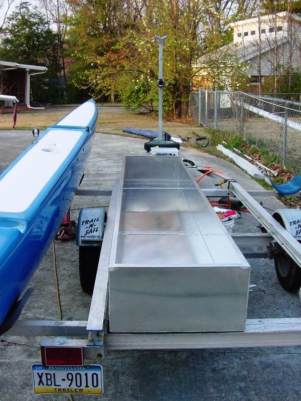

I am just finishing up an aluminum box for our Team Seacats I20. Some installation details on the site (http://www.teamseacats.com).
I've never vented these boxes and they do fine - I do
usually let the sails hang for a while and dry if possible.
Worst case scenario, I put them away wet but they come back
out, once at home, to dry.
Re: Trailer box [Re: Jake] #64197

Re: Trailer box [Re: PTP] #64198
03/13/06 01:38 PM
03/13/06 01:38 PM
Nice work Jake!

Trailer box finished! Some detail and more photos are up on the site.
www.teamseacats.com
